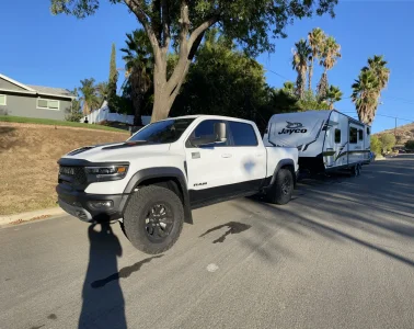

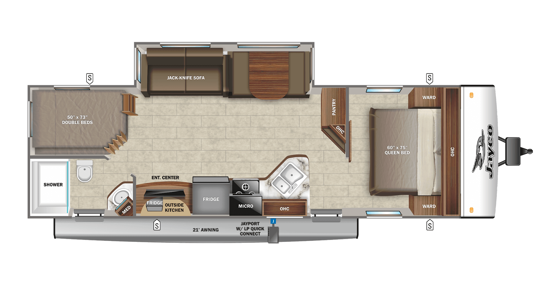

I’m towing a 2022 Jayco Jayfeather 27bhb with zero issues. I’ve towed it loaded with water and all the gear I could fit in the trailer and bed. It towed it with zero issues except for an average 8.7mpg.
