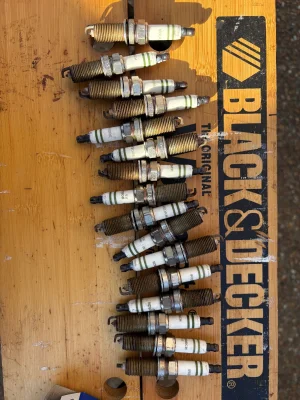

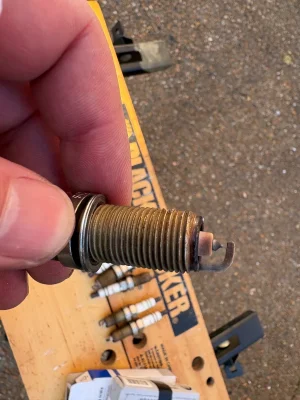

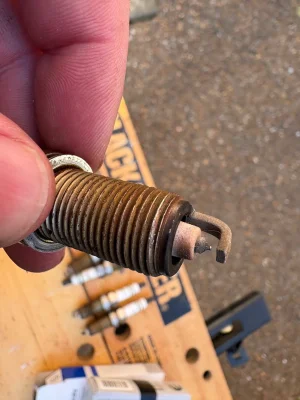

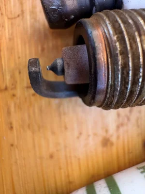

@OnTheReel wutchu think about our plugs at 64.7k?? I think they look dam good!
So here's the box of tools we used to do the plugs. Honestly not as bad as i thought they'd be. It did take about 6-7 hours but we were doing other things to give our arms a break. You will lose feeling in your hands quite a bit so just take your time. We lost 1 coil pack bolt that rolled down into the abyss. Simple M6 x 1" replacement in the toolbox did the trick. I didnt see any torque specs on the coil pack but based on my torque wrench, i'd say ours were torqued to around 50-55 in-lbs. I torqued em to 60 in-lbs when i reinstalled.
Hardest thing was to get the coil pack reinstalled on the front driver & the rear driver. You will have to play an extension game when doing a few the plugs on the driver's side. You'll need to put a short extension/wobble bar on the spark plug socket, drop that down in the hole (not all the way), then hook another extension or wobble bar to your short extension, drop that down into the hole and then attach ur ratchet to the part that's breached the top of the hole. There's very little clearance in some locations so you'll figure out the extension game pretty quickly. Just be sure you're not 100% fatigued before you play that game. You dont wanna start dropping stuff into random holes lolol :ROFLMAO:
We did record a good portion of it with my oakley sunglasses so if somebody wants that footage, maybe i'll piece it together into a chronological masterpiece. 🫣

Horror stories? None of the plugs I’ve seen in this thread look bad at all. Not even a little bit concerning actually. :unsure:

Agreed. Electrode erosion is a thing. Eventually the plug gap will creep past optimum and start stressing things. So as a precaution I’ve always changed out plugs around 50-60k miles… even the exotic ones (iridium, etc). Even if the recommendation is 100k.
Not the plugs, they looked okay. Horror stories about how much time and effort it takes to replace them. You see, I haven't kept a vehicle long enough to need to change the plugs in over 30 years but I really like this TRX.

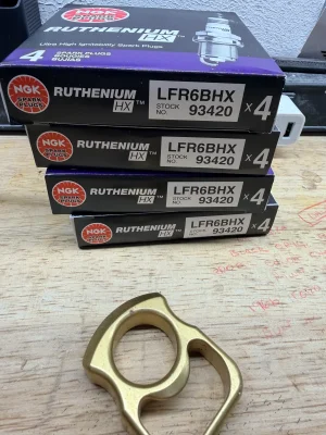

So are these better than iridium plugs?
Meh, there is such a small difference between them all, anything above platinum are about the same. Most of it is just gimmick advertising I’m sure. As long as you get the heat rating that’s required, should be fine.

Wild guess, but probably in the $500-1000+ range depending on the shop vs dealership. Tbh, if you have tools and some brainpower, the job is definitely doable yourself. NGK's from HHP ran me $167.77 for the set, and a little over 3 hours total. Was my first time doing plugs on a TRX too. Probably spent 2 hours on the driver side alone haha. Passenger side was cake in comparison. I did both sides via the wheel well.
