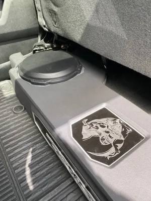

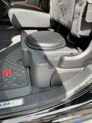

My Truck is done, here is the final build. Focal Utopia 6.5"/3.5"/Tweet 3 ways up front with an additional Utopia 3.5" center. Focal Flax 6.5" 2 ways in rear fill with Dynamat thoughout. JL Audio VXi 600, 800, 1000 amps on custom amp racks behind the seat. (2) JL Audio 13TW5 subs in custom enclosure with a third easter egg! Note: The 13TW5's are on backorder so have 12" JL's in box for now until they come in. Box fits fully under seat with carbon TRX logo on front, full use of recline sliders, cubby access and full factory rear floor mat. Custom pod for Bass and midrange adjustment knob. Oh and did I mention the third easter egg! Sounds incredible...

This looks awesome! Very clean install and as good as it sounds with the 12s, those 13s are insane.
Fantastic work and that's nice they did a little offset for cubby access.
Top notch Joe.

Ive got to do this! Looks amazing. Did they custom build this box? the fit is perfect. Also since you have the HK (which I do) are you only running the 5 speakers you mentioned or did you keep the HK speakers hooked up? Thanks so much!

Thanks, they did a great job. Can't wait to hear the 13's! Yeah every other large sub box I looked at required me to give up the cubbies and with losing the under seat storage couldn't afford to lose the cubbies too...
It sounds amazing! Yeah custom hybrid half wood half fiberglass to get the volume needed without sacrificing the seat and storage function. Here's a pic of the box during construction. Running 15 speakers total. (4) 6.5" front L/R and rear L/R doors, (3) 3.5" front L/R plus one center, (4)Tweets front L/R and rear door L/R, 2 subs.. All the other HK speakers not used.

it looks like they built the box in your truck. is it removable or were these pics just for the mold? Thanks
Its removable. The yellow tape was to protect the carpet, plastic etc. while they put down the fiberglass. Once the fiberglass cured they popped it out and did the final construction, leather, etc.
