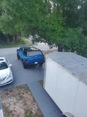

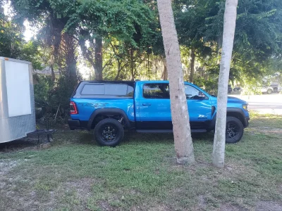

Yeah mine is the same i just took off the brake light with the camera cause i put a canopy , once the light is off drop the head liner a bit open the rear window so its easy to put the antena there
I did try that. Mine is a loaded level 2 with the camera and whatever else. I was told that the headliner would need to be dropped to remove the light.
I pulled the screws and the light was still on therE VERY tight. Didn’t want to brake anything so I put the screws back.

There's a gasket around the back of the light just try to start pulling the light off near a corner

Hello, no the orientation doesnt matter, i didnt use any tape or zip tie , I just put in side the liner and its been there with no problem or issues I did it for the same reason hitting the top of the garage.

it fits behind the third brake light, there's lots of room up there. You can see a pic of it on his first post
