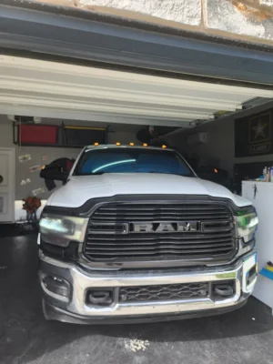

I lived in alaska and now in texas and my truck has never slept out side re locating the antena was because i wanted to be able to still park the truck in the garage after i had lifted the truck , i havent had any issues with the abs one , i have bothe abs and metal but the abs is more sleek i like that one better , our antena does two things gps and vehicle antena i did not want to fully delete it so when i removed it was looking for spots to pur it that was not the dash board well we have a lot of space where i put it at, the dealership will not do it for you.

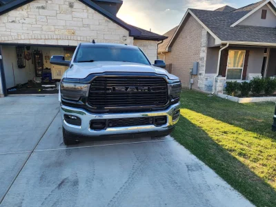

I just bought a ram 2500 and i did the 2.5 inch lift and relocated that antena also , i have not had any issues of water coming in on either truck , I used the plastic one on my trx and the metal one on the 2500 just cause I had already bought it , but honestly i like better the plastic one .

I just bought a ram 2500 and lifted it, 2.5 , and added the clearance lights and relocated the shark fin antena since I did it on my TRX, and the process was the same but i did use the metal plug on the 2500, and I still like more the plastic one
