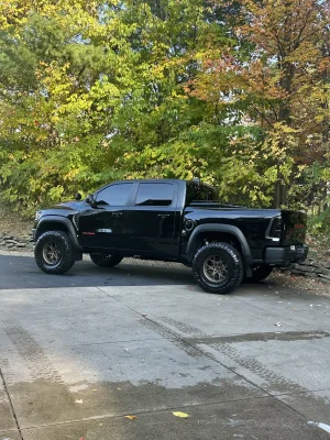

I have the Eibach Pro lift with 37x12.5 on 20x10 -18s, I absolutely love it. I had Ridge Grapplers on my Denali HD and they do awesome in the Buffalo winter. There was some trimming on the inner fender liner and the piece of the mud flap. I actually trimmed back a little of the pinch weld on the cab. But now there’s no rubbing lock to lock on a flat surface, slight if full lock on a sloped surface. View attachment 138306View attachment 138307View attachment 138308View attachment 138306
Looks amazing! I presume that is the 2.7” front/ 1.6” rear combo? I think I will go with this as well as the airbag company gave the green light to taller rear springs. My local shop says 37x13.50s will rub suspension components of stock wheels with either lift as they have done a number of them, so it looks like 37x12.50s it will be.
