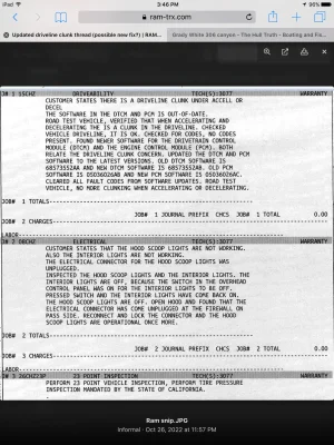

This was posted by @Informal in another thread. It shows the software numbers. Mine goes in the end of the week to have them check the software. Mine had the lube done already and the clunk has partially come back so hoping this will fix it.

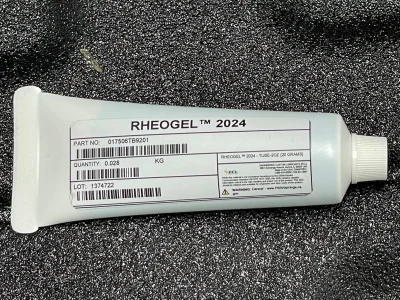

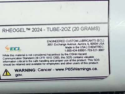

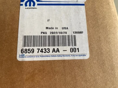

Here's some pics of the lube that came with the Mopar drive shaft boot kit. I haven't applied it yet...maybe someday soon. For some reason the clunk has disappeared the past few months.
