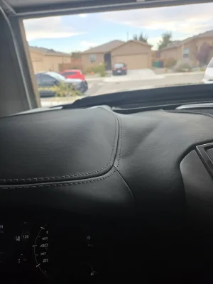

It appears I failed to notice this bubble when I bought the truck. Has 9k miles but it's a 2021 so out of warranty. Gonna reach out to ram cares, what's the username on here again?

That truly sucks! Hope you get them to cover this. It is not cheap, and they have to replace the full dash.
I highly recommend everyone to keep an eye on this and check the view from the passenger side. Better to find it early while under warranty then get stuck having to pay for it. In the initial stages it is hard to see. Mine you could only see it from the passenger side.

I'll have to swing by the dealership and see. From reading online it seems it's about $3500 out of pocket!
That being said, the dash itself is under $600. I'm guessing the labor is the reason for the price.
Another thing I've thought of is having an upholstery shop replace the leather, but might be just as expensive.
Just had the dash changed on my truck , it's a 21 with 60 k miles so no warranty but ram has a "copay" so I had to pay $500 and got an all new dash, and its the same material as the old one( i thought it was going to be different after reading this thread), also they showed me another trx that was in the process of getting it changed and WOW, they take EVERYTHING OFF, the side handles , steering wheel on the floor, center console off, literally everything to change the dash, radio , everyhing it was crazy the amount of work to change it .

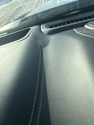

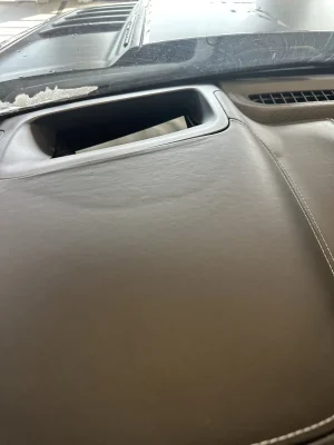

A heads up for others. Issue seems to be growing on 2022 and earlier versions. Due to heat your dash leather may start to bubble or warp. The leather starts to separate from the dash. Not sure if is faulty glue used or what but the solution is they replace the full dash with a new one. HOWEVER... seems like they may have changed the dash leather in 2023+ due to this problem and IMO went cheap. The new version is not as natural and nice looking as the previous one. I am posting some pictures below of before and after. While the version I had was more of a natural smooth leather look. The new one looks more synthetic and rubber looking. Looks more like the plastic panels on the door bottom. Hope I don't have any engine issues, they may replace with a 6 cylinder. Just wondering if any others have had this issue and for those that come across this post to be aware. I think I would have preferred finding another solution.

So I went to see a 2024 at a different dealer and it does have the new material. They told me this change was made during 2023.
I also got some more details in case anyone is interested. The original instrument panel part is 6WR942X7AA and 6WR942X7AB for my model. After that it was revised to the new material part 7TH161D3AA. It looks like this part had been revised like 5 times due to the issues. Not sure if you can buy the older part but sharing what I got.
Had my dash replaced a couple weeks ago, it was replaced with the same PN 7TH161D3AA.
