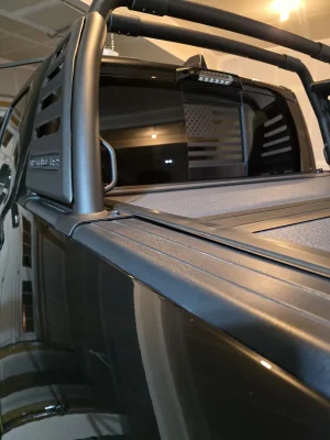

Not sure what you ran into Stu, but I had the rambar already installed, and then put the hard trifold on. It fits, but not great. If you take the bolts out of the side of the rambar, it fits even better so the cover rails can sit lower. However, there's still a small gap due to the thickness of the rambar plate that sits on the bed rails.

I had to do a lot of recon to make sure both would work together. I will say that it still took a lot of ingenuity to get things to line up as good as possible. Here's a final pic of what it looks like without the side bolt.
