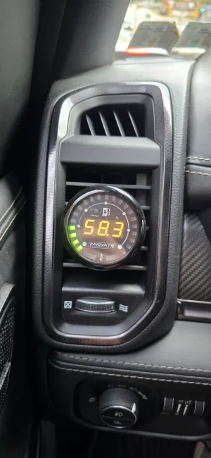

I plan on running E85 the majority of the time. 93 pump gas will mainly be used to occasionally clean out the fuel system, during the wintertime, and when traveling out of state.

Slowly working through the flex tune and increasing the ethanol content.

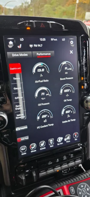

I took a break for a few weeks while Z prepped his vehicle for WCF. We have nearly completed the low boost tune; we are just working on minor details. I'm still chasing a very minor air leak, as there is still a small fuel trim imbalance between banks on light-load and idle situations. It's not affecting WOT; that looks perfect in the logs.
The Kong 2650 runs HOT. An interchiller seems necessary if you do not want to be pulling timing mid-pull. I'm curious to see how high the IATs will climb during a hot Summer day.
50°F Ambient, 80% humidity, -425 DA
My IC temps started at 37°F, climbed to 82°F, and then stabilized at 57°F soon after slowing back down to the speed limit. I started in 2nd gear at 25mph, and it was struggling to get traction with the factory ATs.
55°F Ambient, 75% humidity, -50 DA
My IC temps started at 61°F, still cooling off from a previous pull, when I did a 50-150mph pull. The temps climbed to 111°F and then stabilized at 90°F once I slowed back down to highway speeds.
