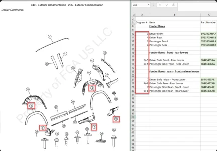

Passenger side rattle. Driving me insane!

I replaced both of those pieces. Noises gone. Crazy the dealer wouldn’t do it but fortunately they’re fairly cheap.
Thanks Rmall for posting this. I’ve got the same issue. Having to drive with the roof open so I don’t hear it. Is this the part number you replaced?
Front Fender Spat, Right - Mopar (68443498AA)​

Yessir! I did both sides to be safe. They’re relatively cheap. Glad to help!
That same part is/was very rattly on my 2022.
The clips that hold it to the body aren't secure - tons of movement.
Rather than replace mine and face the clips loosening again, I'm using closed cell foam expansion units (ear plugs) to force the clips to remain under tension.
Wiggling the part by hand, its fixed.
I'll let you know if it works beyond the edge of the driveway.
Confirmed - the rattle can be eliminated by packing the gap between the body and the plastic with something expansive.
Pulled the mudflap off in preparation for the new spat. I see there are two clips that hold the spat along with the 8 mm screws you see on the outside, did the new part come with those two clips? I'm thinking it is really only the clips that need replacing? The spat itself looked fine. I can't seem to find those clips on a part diagram.
Dunno if the new part comes with new clips or not.
I don't have a picture to share but I all I did was put two fresh ear plugs on top of the flat of the spat between the clips so that they're compressed when the spat is reinstalled.
