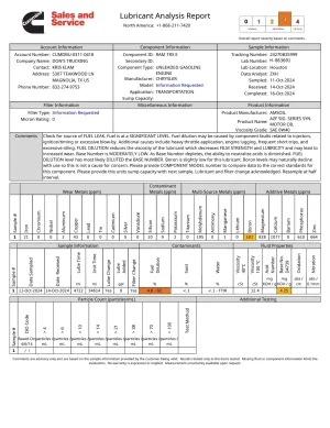

Well this last oil change didn't turn out so good. Truck runs and idles fine, doesn't smoke, no loss in fuel mileage. Not sure where the extra fuel dilution is coming from. Will resample after about 2k miles and see what it says

Mileage?
Short trips? Lots of idle time?
I’d run some Redline SI-1 through the tank. Before the next sample take a long highway trip to burn off whatever fuel you can and then drain hot.
This sample actually would have / could have been much worse with the Pennzoil. The Amsoil at least has some cushion to cope with that amount of dilution while maintaining a decent viscosity. Definitely don’t like to see fuel that high though. Around 2% would be typical for the platform and usually what I see on mine.
I drive about 90 miles round trip for work, about 80 of that is highway. Don't do much city driving, try to avoid it as much as possible. Might get a minute of idle time to cool down or slightly warm up before I drive.
I think the problem may have been that the truck was sitting for a week before I changed the oil, and was not driven before changing. I think that's where I messed up.
Good news is that even with double the miles(4700 vs 2200 on previous pennzoil), the amsoil viscosity was still higher than the pennzoil even with fuel dilution(12.4 vs 12.0).
The last sample showed only 1.4% fuel dilution, but sample was taken after getting home from work when truck was hot
My fuel dilution crept up from last change as well. Going to change next one a little early. I stopped doing short trips to see if it comes down at all.
Do you have a link to the fuel additive you use? Going to start dumping one in at each oil change myself.
I get sample kits through work for about $12 each, so I'll test it at about 2,000 miles and see where it's at. And since I'm so close to the testing facility, I usually get the results back within 2-3 days, so if there's an issue, I'll change the oil and try to figure out what's going on.
Short trips and lots of idle time will do it. I try not to do either, but if I do make short trips, I try to make a long one just for the hell of it
Ordered some redline fuel treatment as OnTheReel advised. Has anyone had an injector leaking?

Well this sample wasn't much better. @OnTheReel What do you think? Any recommendations?View attachment 143894View attachment 143895View attachment 143898
That oil is pretty well hammered by any measure. For reference, the most recent VOA I could turn up for that had a starting viscosity of 15.1 cSt and TBN of 9.08.
What I would do if it were mine…
I know it’s only at 40k of a 60k interval but if fuel dilution is going to be sticky (after trying all the other suggestions made previously), I’d consider putting plugs in it. NGK Ruthenium. But since it did improve a bit, maybe we give it another test first.
Fuel is not the only cause of the viscosity drop, this oil is still shearing. Viscosity was lower this time than last and a spike in iron followed. Red Line 0w40 or 5w40 would be worth a try especially going into the summer heat ahead. In my experience, it basically doesn’t shear at all so it should bring operating viscosity up and hopefully the bore wear back down.
And finally…the easiest thing to do…just shorten the leash a little. 3k, 3500 miles maybe. It’s no problem to standardize the wear for whatever mileage you run and see what direction we are heading.
Nothing in the test is an emergency situation but there’s a lot of room to improve. Which I enjoy digging into.
Reactions: Two
I will look into changing spark plugs, maybe I got one dead plug.
I just bought 8 gallons of amsoil(2 boxes of 4 gallon jugs comes out so much cheaper than buying quarts), so switching oils right now probably not going to happen lol
I switched to amsoil so I didn't have to shorten oil changes like I had to with the PUP oil. But I guess I will if I need to. I will send in a sample at 2500 miles and see where it's at, if it doesn't improve or looks like the oil is falling out of range, I will change it
Thanks for the recommendations
Good plan. And I understand completely. My truck was a tough nut to crack too and I’m still testing things to see how good I can get it. Thankfully I have other vehicles eat all the oil I tried and rejected in this thing.
Ultimately wear can only be controlled, not eliminated. Especially true with a 700hp engine in a rolling brick we drive like we stole. If we get things trending down instead of up it’s a win.
