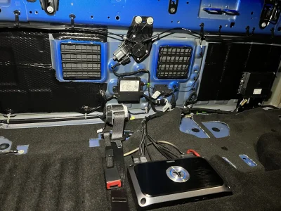

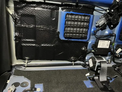

I too have TPMS error now that the jl amp is powered up. Also I get the 3 honks and key fob has left vehicle warning when I start the truck from the drivers seat. The same module must do the keyless entry as well. My amp is grounded to a factory point near what I presume to be the tpms module behind the drivers side rear seat. Will relocate the ground after I get the speakers hooked up to see if I can retain my tpms. Finicky electronics in these things for sure.
Hopefully the ground relocation solves it. Try to put everything as far away from the RF hub as possible, and see what happens. Still kinda wonder if they changed something for 2022. There are a ton of guys running the VXi amps on the 5thgenrams forum in 2019-2021s, never heard anything about these errors. But happy to hear progress is being made.
I relocated the ground to one of the bolts that previously held down the factory sub and that seemed to solve that problem, for anyone dealing with the same issue.
Edit: I spoke too soon. The TPMS is out again…. Anyone with a JL VX amp who isn’t having the TPMS issue, where exactly did you ground your amp?

I disconnected the JL module in case it was a frequency conflict with the TPMS, but no change. The amp should not be putting out any interference, the input signal is fiber optic so it should also not be causing any problems. I disconnected the amp speaker output plug and no change. I hate to run the ground all the way to the battery, but this trial and error and removing the rear seats over and over is annoying.
What side did you run the power wire on from the battery? Did you run it under the truck and then back in or go through the firewall and under the door sill plates? Only asking cause way back when i used to do my own installs I noticed others who did it ran both the power and the rca’s on the same side and got alternator whine and other things. I always did one on one side and then put the other on the opposite. I know in these trucks you’re tapping the speaker wire so there are no rca’s but is it possible there is a wire the power is interfering with or maybe a wire got pinched while running the power feed?
Through the firewall and down the driver's side wire channels. Using optical cable so no RCAs to produce noise. No change with unplugging optical cable, speaker cables, bluetooth module, bass knob module. If amp is off tpms works, amp comes on and its down. Not sure it it is a canbus issue or radio/electrical interference somehow.
