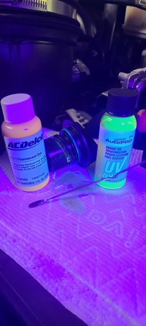

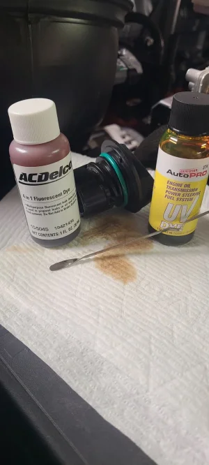

The first oil leak was a loose oil filter that I got almost a full turn on by hand. The second leak was the quick connect oil line fitting on the oil cooler that I was able to reseat and stop. The third leak is out of the weap hole on the bottom of bell housing. I clean up the bottom of the bell housing every day and have noticed that the leak is slowing down. Could be leftover oil from the engine swap that pooled inside the bell housing. I currently have fluorescent uv die in the oil to see if the leak stops or turns fluorescent yellow.
All of the missing bolts and fastener have been replaced by the shop, they also found and installed the missing pulley that was still on the old motor and replaced the belts. I am due in next week for an oil change and engine oil leak inspection. Wish me luck!
