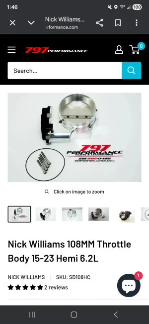

It doesn't say any of that. 797 only had one Nick Williams for the Hellcat on the site... see screenshot. Thats all the info i have.
I do not have the stock anymore.
The Throttle Body is a brand new Nick Wiliams that i bought from 797 Performance. It says it is the NW108 for the hellcat platform.
1. What you currently have (Standard Motor):Nick Williams 108mm: https://797performance.com/products/nick-williams-108mm-throttle-body-15-21-hellcat(notice the standard description—nothing about upgraded motors)
2. The "Boosted" Alternatives (High-Torque Motors):Kong Performance 108mm: https://www.kongperformance.com/products/kong-108mm-hellcat-demon-trackhawk-redeye-throttle-body(look at the bullet point in their description: "High torque motor built to last on high boost combinations.")
OR
SDG Motorsports Upgraded 108mm: https://www.sdgmotorsports.com/product-page/williams-108mm-throttle-body-hellcat-demon(look at their description: "Upgraded electronics: Enhanced performance with no closing issues under high boost conditions.")
so, your physical hardware diagnosis remains exactly the same—your massive blower is simply outmuscling the standard electric motor inside that nw108. ironically, you bought your snout from sdg, but your tb from 797. if you had bought the tb from sdg, you probably would have gotten the one with their upgraded electronics!
send the log to ryan first. if he says he can't fix it by bumping up the drive-by-wire current in the tune, you will likely need to ditch the standard nick williams and swap over to the kong or sdg 108mm so you have a strong enough internal motor to physically hold the blade shut.
