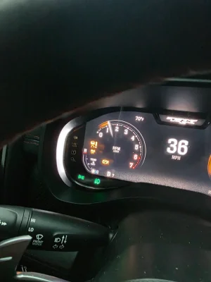

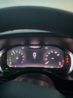

After a few revisions of tunes at WOT, out of nowhere I went to launch from a dig, brake boosting, no launch control, and it went into a limp mode and threw a few codes. Pics of the lights will be included. No engine codes.
We thought it was tune related so I took it to a shop in Houston to do some in person tuning and fix the oil leak mid January. During the 2 hour drive to Houston I came up on a Rapotor R and i wanted to play a little...was going 85 on cruise control. Gunned it to catch up to the Raptor R and as soon as it downshifted it wentninto the limp mode again. Shop could not get the limp mode to repeat when they worked on it...

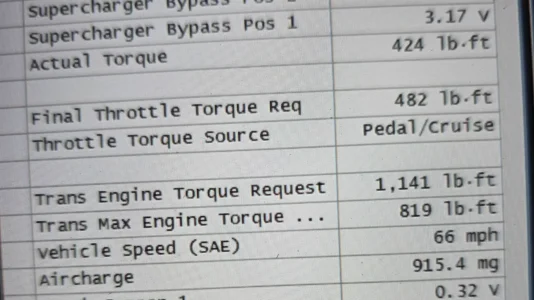

I did get a datalog where it happened while driving with cruise control on at 65 mph on the highway in early February.......I only see 1 thing that stands out to me...
At 65 mph, 25% Throttle, I have the following IMMEDIATELY BEFORE it goes into Limp Mode:
ACTUAL TORQUE - 424 lb
FINAL THROTTLE TORQUE REQ - 482 lb
THROTTLE TORQUE SOURCE - PEDAL/CRUISE
TRANS ENGINE TORQUE REQUEST - 1,141 lb
TRANS MAX ENGINE TORQUE - 819 lb

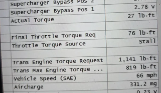

When the issue hits and it goes into limp mode, in the datalog those numbers plummet rapidly until this happens:
ACTUAL TORQUE - 27 lb
FINAL THROTTLE TORQUE REQ - 76 lb
THROTTLE TORQUE SOURCE - STALL
It does this in the timeframe of less than 1/2 of a second in the log and as soon as it changes to "STALL" is when I go into limp etc. And it throws the codes you see in the pictures. Throttle position is still the same (cruise control, flat ground), soeed is the same, etc.
I included screenshots of the datalog. I do have a video of the datalog, as well at the log itself if anyone wants to see them.
