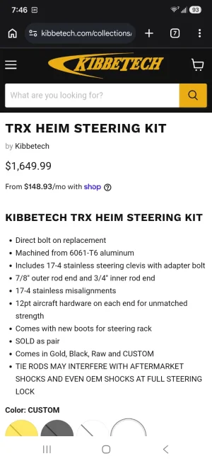

Running kings and the kibbetech heim steering kit, noticed the kibbetech helm steering rods rubs on certain turns like full lock, or when im turning in an elevated parking garage. Anyone else have this issue or got a solution, or is this normal?
well hot damn, seems a little flawed if it rubsIt is normal it says it on their site, last bulleerl
Agreed, someone had posted about this a few years ago that's when they added that bullet.well hot damn, seems a little flawed if it rubs
