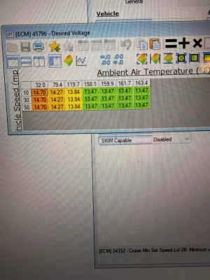

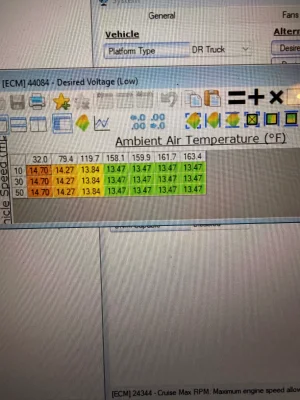

I leave my truck plugged into a battery tender every night. The tender shows that the battery is fully charged at 12.6V and in good health. 90% of the time at startup, idle, and while cruising, my voltage will be around 12.6-12.8V, no matter how much demand I put on the battery. During the winter, I've seen it hit a low of 12.3V. It jumps to 14V on deceleration and WOT.
Just found these two factory maps for the pwm alternator targets to temperature
