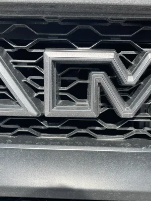

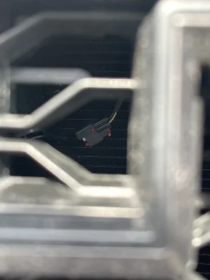

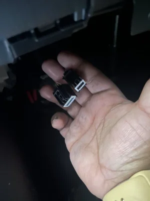

Anyway reach under ur steering wheel. They disconeeceted two harnesses. Mine was the same. I plugged those two back in and everything worked fine. They also disconnected a harness to my horn right thru the fuckin grill. If ur horns dead look behind the A in ram in the grill. Small two wire harness they unclipped. Ill attach two phots for u. U from toronto or gta?

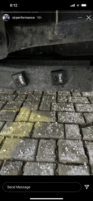

Buddy heres one from sherway thank god the valet guy told the owner. He looked and found these on hos 5 link suspension. Back left corner. Also this is a pic of the fucker that did it and tried to steal mine. U can buy these on amazon and pay monthly for service
