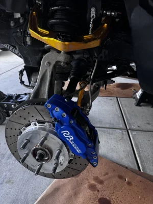

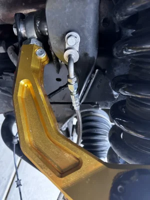

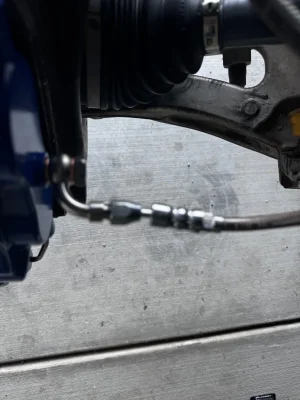

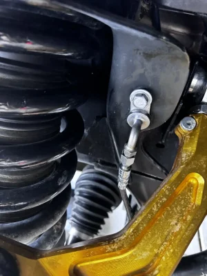

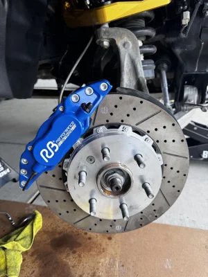

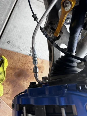

Here is my setup, let me know if your interested!
