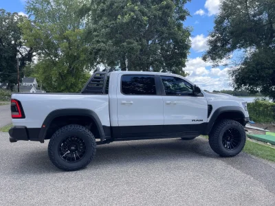

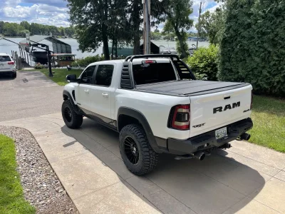

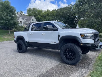

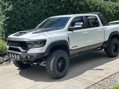

Geiser springs and 37's on today!!
Did the springs and 37's today, stock bead locks powder coated black with real bead lock rings. Install was easy, about 2.5 hrs front n rear.
The ride and suspension definitely isn't as smooth as stock even driving with the stock tires but I'm hoping having the suspension reset solves this. Still rides good but it feels different now especially on the little bumps. Pretty sure the reset will fix it. Love the look. The stock wheels look bad ass black. Maxxis razr tires and I've ran these on many trucks and they are load d like the factory tires. These tires drive great and make very little noise.View attachment 47244View attachment 47245View attachment 47245View attachment 47244View attachment 47246View attachment 47247
Looks sweet. Very curious how it feels after you do suspension reset. At various angles, I think the stock 35’s just look a little weak in the massive wheel wells. Would be great to hear about 37” m&s tires that don’t suck power and still ride nicely.

Sweet ride. Is the front of the vehicle higher than the back of the vehicle or optical illusion?

Installed Geiser and 37” today. Overall super happy. Ride quality feels solid and almost prefer to stock springs. Definitely glad have the ram power steps as it’s tall!
