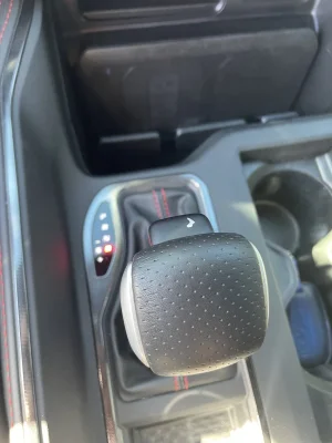

Mine just chipped today, 2023 with 10K miles. I happened to be very close to the dealership so I decided to stop in. They were able to verify it should be covered under warranty and will get one coming. Still kind of frustrating this happens but the dealership seems like they will make it right.

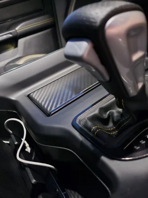

This is mine:
23 noticed mine at 5k miles currently at 8500 miles will be bringing it in for a warranty exchange ‼️🙄

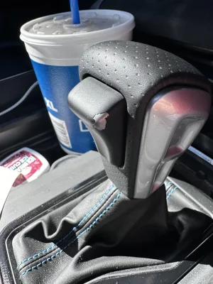

2023 lunar with 3K miles and I just noticed it today! Gonna do a warranty claim when i do the next poil change there

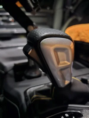

Mine starting chipping around 3000 miles. I decided to peal it all off to see how it looked after I ordered this: https://www.mhfautolighting.com/pro...ram-trx-shifter-matte-yellow-cf-havoc-edition.
It looks decent in grey. Had I peeled it off before I ordered the new shifter I would of been less inclined to order a new one but the carbon fiber is pretty cool so I'm content.
After posting the pic I realized I didn't get all of the black off from the inner area. I had never noticed it. Oh well, the new shifter just shipped after waiting three months. Looking forward to it.
