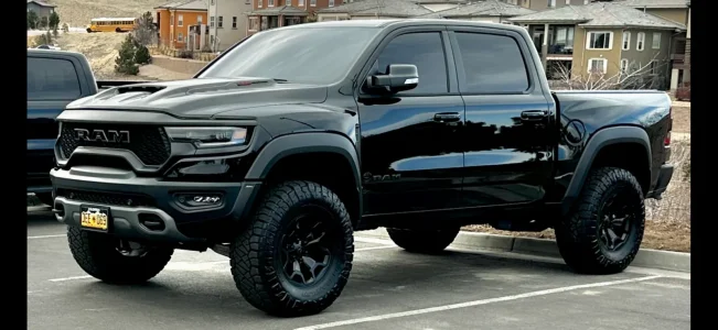

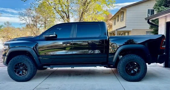

I just switched my front springs from Geiser 3.0” to Eibach 1.6” last week specifically for the ride quality. Just put 1500 miles on them and can confirm it feels so much better than the taller spring I had installed before. I left the Geiser 1.5” spring installed in the rear because I do load the bed up from time to time and would prefer to not sag in the rear. Still running 37” tires just fine as well. The 3” lift definitely looked better and more aggressive but it was such a harsh ride for my personal preference. I’ll post a pic of how it looks now compared to the 3” Geiser springs.

Thanks for the feedback. Glad to hear the 1.6 ride good. I hate to ruin the ride of this truck.

I noticed you have the ridge grapplers as well. Would you say the ride feels much better almost like stock? Are small bumps and potholes much smoother? Does it feel like the shocks are cycling better compared to the 3” Geiger lift?

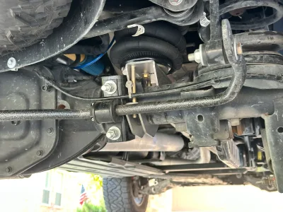

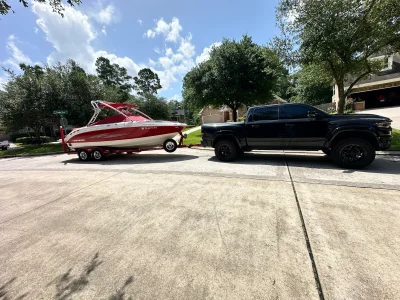

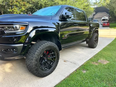

I have the heavy duty springs in the rear, IMO the ride is better than stock especially if you are towing or the bed is loaded up. I was most assuredly over payload last summer on one trip and could barely tell there was anything back there.
I *also* own the Timber Grove air bags, but I’ve not installed them. Has anyone done both?

Steve at TimberGrove recommends 3psi in the Gen2 when not in use. He says it lifts about 5/8 inch. Much less than gen1. The ride is better also in my opinion with gen2. Nothing negative about them but I have only had them with a Hellwig sway bar
