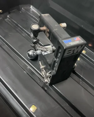

I have a B&W Tow & Stow. Triple ball, 5” drop. I didn’t buy it for the TRX specifically or anything, used it with my last 3 trucks. But it works.

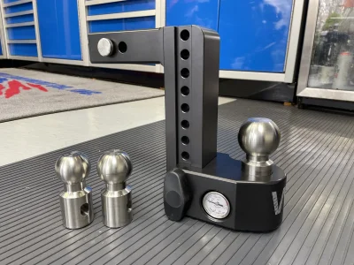

Actually eying up that Weigh Safe though. Would be nice to have something a little lighter and less clunky. This forum is always good for spending my money.

I picked up the weight safe 8 inch drop hitch with the 1 7/8, 2” and 2 5/16” balls. Very nice quality hitch I never own one before I’m very impressed with it.
Did you go with the Cerakote Black Drop Hitch (Aluminum) or the Steel Drop Hitch?

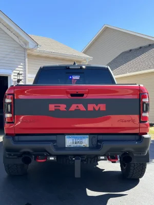

Hey guys, so the trailer I am buying has a 20 inch coupler height from the ground. And my TRX measures about 23" from bottom of hitch receiver to ground. Weight safe has several drop height options, I am thinking the 6" or 8" would work. Just dont want to drag the bottom of the hitch on rough road when it's all loaded up, so I am leaning towards the 6". But then the trailer might not ride perfectly level. So I am not sure which one to get.
