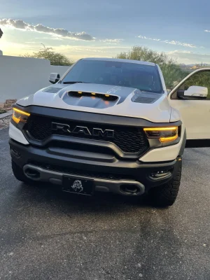

Hello,
I have seen some trucks with the amber running lights above and below the headlights.
Can I do this on my truck, or is that taser device needed?
Thanks
Yes the Tazer gives you that function.

Tazer!
With latest firmware on Tazer DT you can also activate the marker lights in hood scoop and each corner along with the amber halos in the headlights .

It's on their website - not sure that it's '22 specific, the latest version is 18.1.0
I believe the setting is for DRL Location and then select turn signals (or vice versa). Make sure DRL are also enable in the Uconnect settings cause I've seen them sometimes get turned off.
