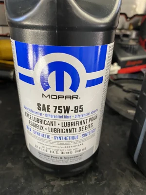

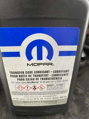

Did a second, REAL PDI on the LE today.
For those that were asking what fluids for the transfer case and diff these are it.

Checked the rear diff, fluid, transfer case, and front diff. Rear diff was fine, transfer case and front diff were really low on fluid.
