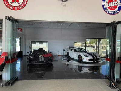

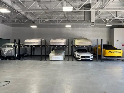

Great looking shop full of even better looking materials!!

Very jealous of your garage.

How much room do you have under the truck on that lift, and what is what is lift model? I was thinking of getting a 2 post with an open top to allow me to stand under the truck.
I'm 5'9" and can be underneath it without ducking or hitting my head. All of my two post lifts are Atlas lifts, I need to pull one and put a 16k lift in, these ones can't handle my 3500. You need to keep the top closed, that soft bar up top stops the lift when if the hood hits it, so you don't smash the truck into the ceiling.
