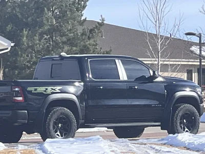

Quick parking lot pic today since a just cleaned her up!

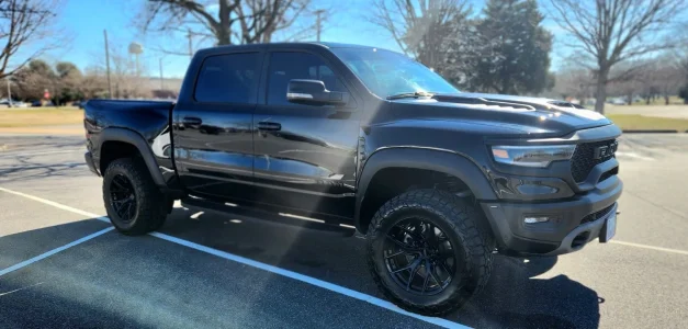

Thought I’d share some new exterior mods
PPF on entire truck stealth on roof and lower
Gloss everywhere else (PPF a must imo with black paint)
Smoked mirror signals
1in level
37x13.5 18 BFG ko2
Fuel rush +1 18x9
Only gained 3lbs per corner from OEM setup
Weather tech mud flaps
Backflip bed cover
TRX and hellcat badging instead of Ram
Re decal OEM decal hood and bedsides
BAD MPGS Texas plate
So far happy with my setup

Gosh DAMN it looks monstrous. That is goals for my ‘23

Did you have oem beadlocks?

Was the 1 inch level necessary to make sure there’s no rubbing? And I’m assuming that’s just 1 inch in the front?
Any performance loss with setup?
I’m sure there is but I can’t tell.
I believe Trunity on the forum with a similar set up lost .2 sec 0-60.
Trucks handles great with a wider stance. Tires are about .75in wider and the offset in about .75in farther out than stock
So far gas mileage is only .5mpg worse based on the trucks computer
Yes.
You could probably go stock suspension but would need to pinch weld the metal on inside wheel wells with some plastic trimming if turning to full lock
Stock offset would probably work.
I did not want to change the ride much from stock
It just an Icon front top strut spacer not preload collar
About as mild as possible to clear without rubbing.
I also park in my garage so I wanted the best setup to look aggressive and still fit in the garage.
