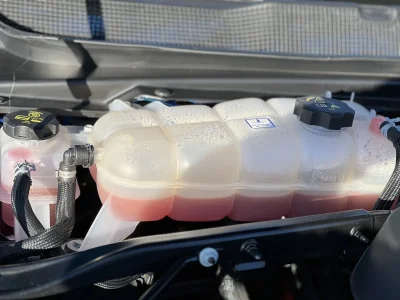

I was reading this then I decided to check on mine. please forgive my ignorance but This is how it looks now. Below the minimum line. I purchased the truck in 2022 with 15 miles on it and got about 9000 mile so far. when purchased was exactly at the minimum line and never added coolant to it.
does this look okay? I'd like to address it sooner than later if the case maybe.
I had to add about 3/4 of a gallon of coolant in about a 6 week timeframe. The reservoir was almost empty when I caught it. Your supercharger reservoir looks low.
Coolant does not connect to, or used by the exhaust. Could be leaking into the engine (very bad) and sent out through the exhaust.
That is the understanding I'm getting.
I never added coolant to it.considering the cold and hot weather that might cause the antifreeze to either expand or shrink. I show the pics to some ram drivers today and told me that this is normal but 🤷
