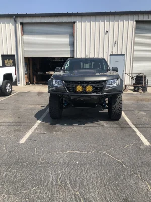

track width of the front tires below is 77 inches. And that was with stock arms …new arms track width is 80 inches.
