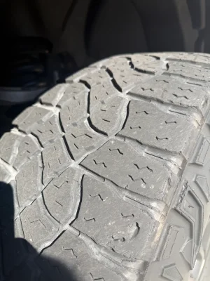

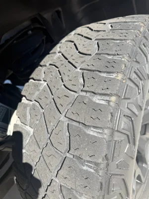

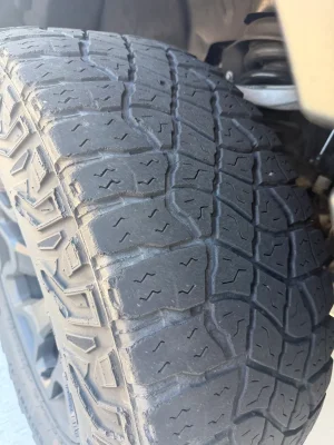

minor of the originals with 40,000 miles on them. I’m still running them. There’s been times I step on the brakes on the freeway and I feel vibrations, and I feel it in my steering wheel. Thought it was my brakes, but after an oil change tire rotation, it would go away. Rinse and repeat, and I would feel it again after the rotation. Now to the point where I feel it between rotations. Figured it cuz the tire are worn down but I could be wrong. Got a little bit of tread left.

How many times have they been road force balanced in those 40,000 miles?
If they(dealership) didn't rebalance them when I asked for a rotation during my oil change....then I would say they were balanced from the factory and that was the last time. 😂🤣 maybe it is my brakes cuz it still a smooth ride everywhere I go.
I took a closer look at my tires and saw that I had some pretty bad cupping.
As I understand it, the Falkens have staggered shoulder blocks at tire edges to prevent this type of wear pattern.
This is what my Territories look like now:
My tires looked exactly like yours. Finally switched them out to Falkens today and it was like driving a new truck. The toe was pretty significantly out of alignment which came that way from the factory no doubt. I'd be interested to see the reports of your alignment because I'll bet it's similar. Regardless so far I really like the Falkens but in all fairness any new tire is better than what I was dealing with.

It looks like they're feathering, not cupping. My last 3 trucks wore like that, including my TRX. Not sure it can be eliminated running AT tires. I keep to a minimum by doing frequent rotations.
I think the AWD combined with the HP/TQ of the TRX causes tires to wear quicker. I keep my tires at 37psi and rotate them every 4,000 miles. It’s not a perfect solution, but so far on my General Grabber A/Tx it seems to be working better than the stock tires.
