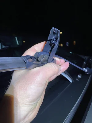

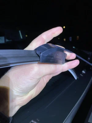

Just got these and they don’t fit. Won’t push in any more than this. Anyone else have this issue with the Bosch Icon 24A?

Oddly enough, I just put a new set of Bosch Icons on today. And yes, there’s a trick to putting them on correctly. The lid that flips up has to be at the outer end of the wiper arm. When you close it, it’s what keeps the blade assembly from coming out of the j hook.
So yours is installed the wrong way. Flip it around, pass the j hook through the opening, hook it completely over the assembly, and pull it tight to engage it. Then close the lid. If that makes sense.
Appreciate all of the advice! Just went out there and got them installed. I was truly convinced I bought the wrong ones lol!
