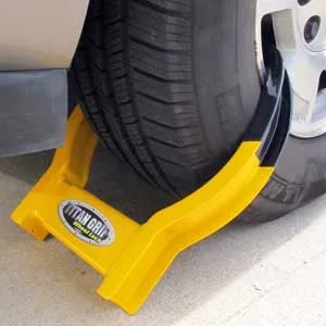

Club on the steering wheel and a tractor trailer boot, 2 way voice recording cameras and a big ass German Shepherd and a bigger cat
