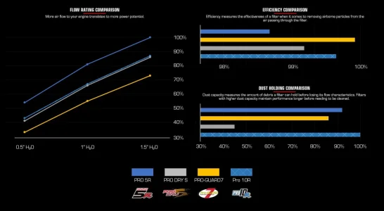

If you are going to replace the filters and off-road, AFE recommends their Pro Guard7 series filter. They mention that their Dry filter is ideal for Street driving.
A graph I found on their site comparing the filters Performance/function.

Our ProGUARD7 media is the most restrictive but offers the best filtration. You really only need to use this if you're in dusty environments. Its still an oiled media, so it will require re-oiling down the line, but the oil is really what captures the finer dust particles.
Just ping me if you have any other questions.

Oiled for best performance and whine. Cleaning the filters is the same process either way, you just need to reapply the oil to the oiled media.
I personally run dry media on my daily driver, and oiled media on the weekend toy.

Thanks. That’s exactly what I got from the chart you guys have posted under the filters. Glad to see you all are shipping out these filters now. Called today for product inquire and was informed that the Momentum GT is pushed back until late May and the super stock is looking like mid-late March
