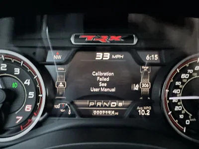

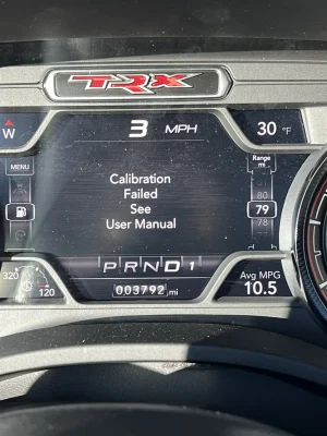

I run a 37inch tire on 22s. Has anyone gotten this message before? Wonder if it’s the sensors or speedo that is causing this to pop up. It goes away after 2-3 seconds.

No, neither of those items. It’s a very common problem on all the latest Ram 1500’s.
Do you have the trailer steer option? Looks like there is a bulletin out for this and it’s directly related to the trailer steering system trying to calibrate when there isn’t a trailer connected. Looks like there is no fix right now for that and it will be handled in a future UConnect update according to my dealer.

I'm stock height and stock wheels and tires. I too have been getting it since I got the truck. It comes on every time I drive it after about 2 minutes. Dealership has no clue...
Do you have trailer steer assist or whatever it is called? Looks like it's a common issue on Ram 1500's with that option and that needs to be recalibrated.
I do... I'm going to let my dealership know that there is a TSB out for it.
Yes I have the reverse trailer steering. Thank you everyone for letting me know! I’ll be on the lookout to when a fix comes available. Glad it wasn’t something too terribly bad.
