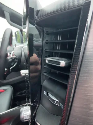

Passenger side you can clearly see the radio is not flush with the dash and vent. The driver side is fine.

Clips probably aren’t seated. Take the two screws out of the top, grab the top and yank really hard. Then re seat all the clips
