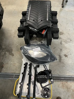

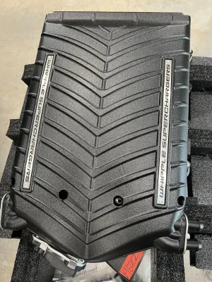

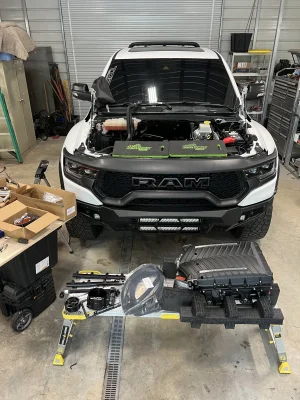

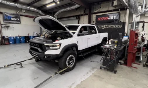

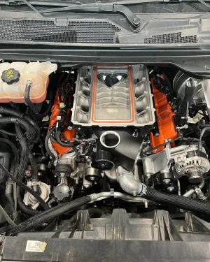

I have completed the install and base tuning on my Whipple Superchargers Gen V 3.0.
Currently I am at 851 whp with only a base tune and 3.75 pulley on E85. Will be turning it up over the next couple of weeks and pulling a lot more power out of it, especially after we install the Ripatuned TTRX (twin turbo). We are expecting over 1,000 - 1100 whp out of this set up.
Currently only running 16 lbs of boost with the pulley that comes with it, a 3.75

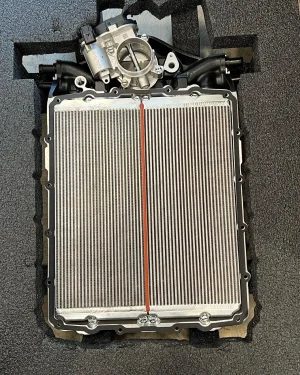

As you can see in the photos, the Gen V Whipple 3.0 has 3 times the cooling capacity of the stock blower. I have been running around 105-115 IAT's in 90+ degree hot sunny days I have not really beat on it any at this point, but soon will I can assure you.

I have spent a lot of money with Ripa, so I was able to get it a lot less than $10k. I got everything that is in the pictures below and air box, ductwork and so on.
