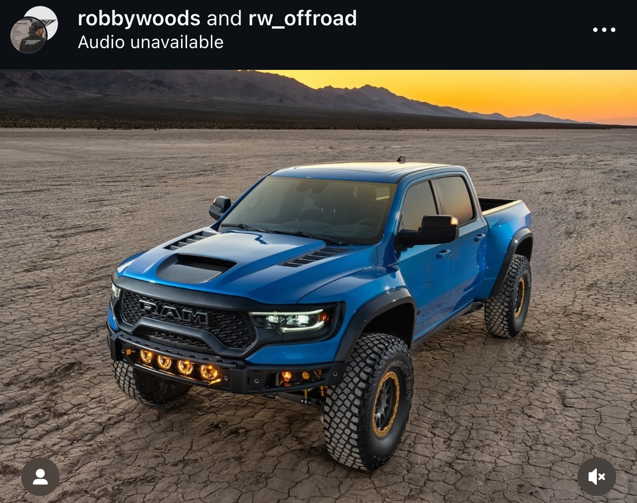

with 40” tires you definitely have better ground clearance, but look at those pictures of the guy on 40”s. UCAs are declined as hell. That means he hasn’t any space for suspension rebound, so it doesn’t work at all. Similar to walking on your toes . And of course CV failure will be something you will face quite often. So imho it is more for the appearance. Robby Woods is driving on 40s but it is completely different story with no OEM suspension parts at all
Truth! HOWEVER every guy that's on 40s in a Rex is on 20" wheels so airing down a 40 on 20s is probably no better than airing down a 38 on 18s. See how i did that math there?? haha. There's definitely better tire options out there for 20" wheels but I feel like i'm losing half of the benefits if i go to a bigger rim. The tires ive found weigh within 1 pound of my 38s so going to a bigger, heavier 20" rim will increase my unsprung weight which i really dont want to do unless i have to. PLus i want that extra sidewall
Man that is a good point and def something to add to the cons list
