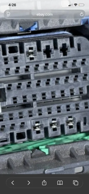

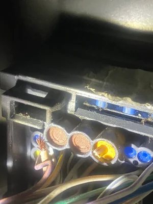

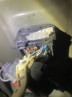

Cable somehow is ripped. Any idea on the type of pin used?

Assuming this is the XY400 connector on the bottom of the floor pan under the driver seat?
If so:
Terminal is TE Connectivity 1-968855-1
Wire seal is TE Connectivity 967610-1
