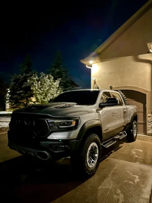

Ya I’m crazy lol the first one I bought when they first came out and I feel like I paid too much so I had it for 6 months and got lucky to get my money out of it. Second one I bought about a year later but it was an insurance theft recovered on which I purchased way below market ($35k cheaper than market price, hence no warranty) I had that for one for over two years and sold it as I racked up the miles but by far the best one I owned. Third one was black which I instantly regretted. Kept it for like 5 months. I hated the upkeep with black. Now I’m back to another theft recovered silver one lol
