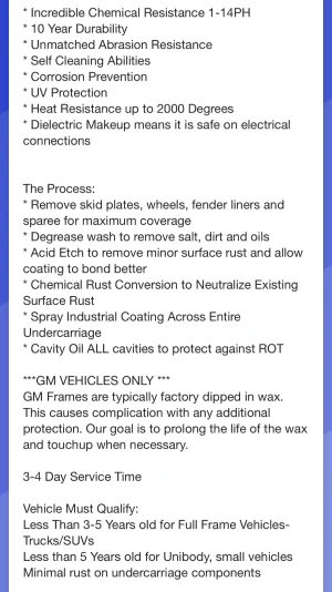

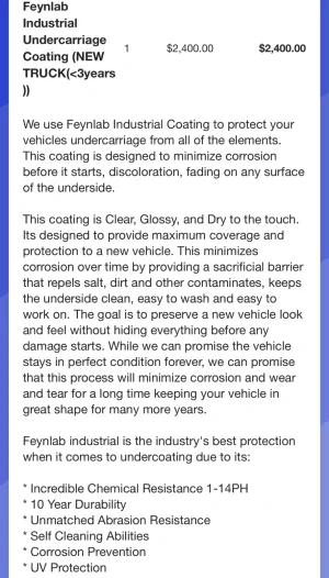

I feel your pain. I deal with the same issues in the upper Midwest. I’m going with Feynlab Industrial Coating. It’s a clear industrial grade ceramic coating. It dries glossy and completely dry to the touch. It’s been used for years on oil rigs and heavy machinery, etc. Not cheap, but neither is a new truck. $2400 for a new TRX. What I really like is the undercarriage will still have that showroom look when it’s done. I wasn’t too excited to coat my brand new undercarriage with fluid film or wool wax. https://www.feynlab.com/product/industrial/
