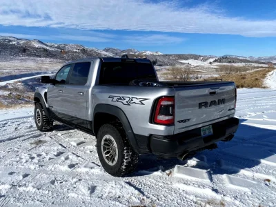

Ok I was able to get bedside decal measurements from a friend, so I can make new ones that match the factory ones and also include the T-Rex logo next to the letters. Problem is, the left side decal goes right up to the taillight:I would like them to be the same size as the factory bed decals.
I actually dont want the TRex head on the decals, just the “TRX” so problem solved there. What quality material are you using? And yes, your pricing is very fair..Factory prices for the graphics are insane....Ok I was able to get bedside decal measurements from a friend, so I can make new ones that match the factory ones and also include the T-Rex logo next to the letters. Problem is, the left side decal goes right up to the taillight:
So there won't be much room for the T-Rex head unless I:
A. Make the decal anyway and you just install them further towards the front of the truck
B. Put the head below the "X"
C. Put the head before "TRX"
D. (insert your own option here).
Let me know what you guys would prefer. It will cost about $50 for the pair of bedside decals with high quality vinyl, shipped. Hope that sounds fair, as they are relatively large decals and will have to be shipped in a tube. Much better than the $1400 Ram charges...
