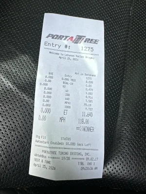

Ran my TRX at the track today finally after a rebuild. Temp was 48 degrees with 603 feet above sea level. Truck has a ripatuned 800 package on a 94 octane tune with an S&B intake and forged pistons and rods
