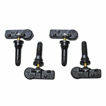

Something I came across that seems like a real deal running right now is 4 TPMS sensors 433mhz for $28 (originally $119).
I literally just bought a set off eBay for the lowest price I could find and paid $90 for the set.
So jump on this if you need TPMS sensors (I understand the 433 mhz works for our trucks, but you should verify on your own).

Correct me if I'm wrong (just went through this), but I'm fairly certain if you don't purchase TPMS that are programmed for your truck, they need to be reprogrammed (easy to do at any dealer). Once they are programmed to the truck, they are installed and the vehicle relearns them. Mine did this within about 2 minutes of driving.
I took the advice of others and ordered these:
After receiving mine, I went to the dealer to make sure they were programmed, which they were, then to the tire shop for the wheel/tire install. Worked out great and I highly recommend them. OEM TPMS for a Great price!

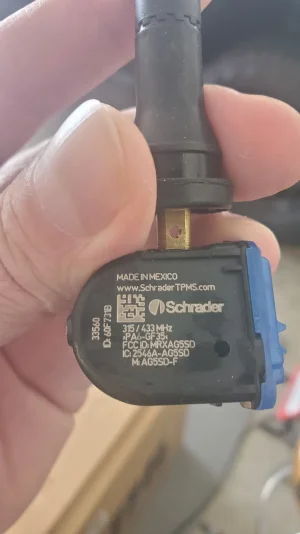

If the sensor is the programmable type, schrader, max sensor ect then you can program them to the needed vehicle/frequency. If it has an oem part number like the ones you posted then they are only made for that vehicle line/year. 98% of mopars after around 2008 auto learn after you put new ones in or rotate wheels. Others need to do obd relearn. Some models have a tpms reset button, you turn ignition to run and then hold the reset until it blinks.

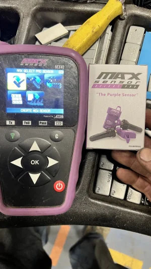

Some like the ones we carry come blank and will not work unless they are programmed to a specific vehicle and year. The ones in the pic are what we use for 99% of the vehicles we service. They are just blanks and then you upload the needed firmware and frequency needed.

Update on mine... local big o shop used an older bartec 400 and put my vehicle info in. Turns out they didnt do it during install. Went to each tire and let it do its thing. Did not have to plug into obd port. Let it sit 15 minutes then hit the highway. Within 5 minutes on highway it started reading them fine for now... saved me from buying my own programmer. I never thought of trying to use the trailer tire sensors that came with truck. I'd have bought mopar but got schraders thrown in the deal for free when I bought wheels.

Schraders are programmable for most of them and a few different scanner/programmers work. We use an older snap on one for those.
