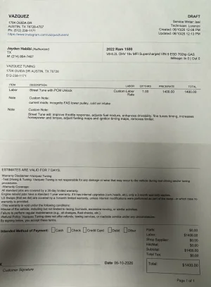

I got a street tune quote for my 2022 TRX. I was wondering if this is worth it?

I mean you don’t need a tune for your mods, the trans tune will be very noticeable.
Me personally, I wouldn’t tune it unless it’s necessary for the mods. Better off doing a pulley and injectors while your at it
I agree with @Louk, for your mods the tune would not really be worth it. I would confirm that the cost also includes the transmission tune as it only states PCM and not shift points.
