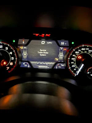

Well update. 10 times today driving on highway that has intermittent red lights at different suburbs in a row….would be going 50 then have to stop or slow. When I would get to about 10 mph error codes would start flashing 3 or so codes on screen and it would go into limp mode. Have to put it in park and turn it off then on again and be fine….this happened about 10 times in a 3-4 mile stretch…..would this be tune related or something completely different with a bad sensor.? Starting to worry I may have gotten into something that may have been dumped for issues or mods? Afraid when I take it to dealer they will see mods and laugh…..?
What are the codes it's throwing?
Stability, then something else then trailer break….tried to get video but doesn’t do it all the time .

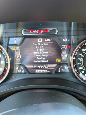

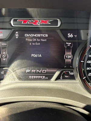

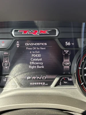

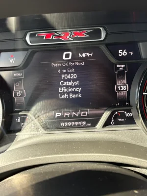

Scroll up one to the Diagnostics page on the screen; it features the stethoscope symbol. Run diagnostics and report back with the errors.
Here is what it shows

So it sounds like something isn’t tuned right with the headers and throwing the cat codes
Then a torque management code, probably tune related
Your last one might also be o2 sensor tune related …..
agree with above, unless you got a screamin deal and are prepared to possibly get a several thousand bill I would try to get your money back and get out.
