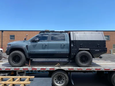

I was wondering if anyone with a heavy load had any more images? I did order these springs and I am waiting to get my truck back from Bowens Customs to install them, but i need it bad. IM SAGGY.

Badass rig man! We just weighed in at 10,160lbs fully loaded so we've probably got ya beat! Our HD springs were hurting pretty bad!

Thanks man, I will not sleep while its in transit to me! I do not think I will be there, I am thinking I will be there. I estimate without a small overland trailer, and all my gear the truck is like 400 over factory. But most of that is in the rear, and currently no spare tire. I am just hoping it works out.
Wowza! Is that the RSI rear bed replacement?
Similar, its made by Bowen Customs in Colorado. American Made.
Thank you! These HD springs are going in today fingers crossed they are enough.
My rig has about 400-500lb in the bed between the camper shell, decked system, and other items. I also have the Eibach front springs and it's all on 37s. It sit's with about 1/2" to 1" of rake, though it's hard to tell.
