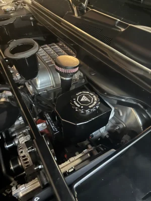

@TRX_1K thanks for the recommendation on the Fen Fab coolant tank. Looks great and easy install. It fits perfectly with the cornerstone intake.
One question- How much coolant did you put in? I know it fits more than stock but also don’t want to overfill. I probably have an extra quart in then stock to start, it’s slightly above the sight glass.

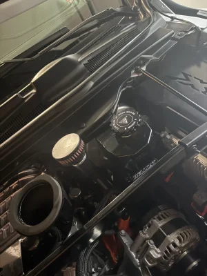

Finished some of the engine bay today. Big Thanks to @DMR for the help installing the Fenfab coolant tank and the custom caps from American Brothers.
Tank had a small leak, sucked to drain it and swap back but Fenfab took care of it and fixed it quick. Thanks to Brett

Had cap painted to match the engine red accents

Looks great man. Glad you got the leak figured out with Brett.

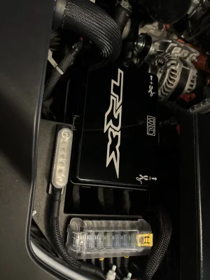

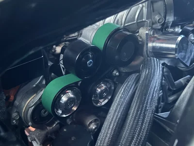

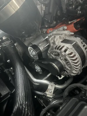

Added Serpentine/accessory belt idler pulleys to match the already installed drive belt tensioner pulley, adjustable idler and fixed idler pulleys. The stock plastic pulleys drove me nuts. Also added the American Brothers fuse box cover. Came out great.

Did the pulleys get noisy after install? I replaced one that rusted and the new one was loud. I did break in and got better but still louder than the original before it started squeaking.

No noise at all, these new ones have better bearings and look much better. Below are websites for all the pulley’s installed:
Drive belt pulleys: ribbed tensioner pulley (know which stock tensioner you have as they have different ones, mine was Dayco) and two idler pulleys- Metco
Adjustable idler pulley- AAD (I bought mine from @Nick797 )
Serpentine/ accessory belt idler pulley’s- TBA Machine
Easy installs and replaced both drive and accessory belts at the same time with gates. If you go with the AAD adjustable idler pulley you need a longer drive belt- went green belt and this one fit perfectly- K100586HD. If you don’t go with the adjustable idler (for supercharger wrap) the stock drive belt size will work fine.

That’s a deal for all three drive pulleys for under $300. Just make sure you know which tensioner you have- my 2022 was a dayco but could be the mopar one if another trx year. The bolt sizes are different, learned that the hard way.

Can’t find a brake reservoir cover for the TRX so ordered one for a diesel Ram and did some cutting and grinding. Came out well.

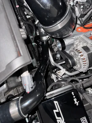

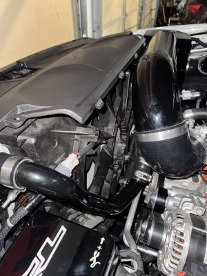

Added the jmb hard coolant hose a few weeks back as well. Nice little project. I have the billet tech thermostat so took a little tweaking to fit right. Came out well though.
