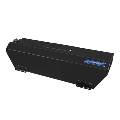

There are several US based after market manufacturer for in bed fuel tank like this one
Sound promising
