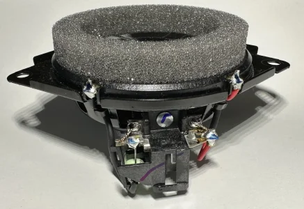

Installed two front corners and wow what a difference. I didn't notice how muddy the stock HK sounded until I heard the 3032's. It's very clear and the loudness is pretty much the same as HK but just 10x clearer. I had the stock HK at +5 treble/mid and the 3032 in was able to bump up to +9 treble/mid without any distortions.
Here you can hear the clarity as I fade from left (HK) to right (3032). It's night and day difference!!
These speakers are on Amazon for 2 PAIRS at $78 so I'm going to change the center dash and rear headliners as well. You also need the Metra 72-7902 harness.

Pretty cool for sure you sure notice it on the high end, and got rid of all the mud down low as well, Infinity used to make a even better version of this little speaker but discontinued it years back can you post a shot of the stock HK speaker ? like to see the hunk of crap they installed lol now to find replacements for the big door speakers, thanks for posting your results !!!
here are the old ones https://www.crutchfield.com/S-AyrlP3qt7tC/p_1083032CF/Infinity-Reference-3032cf.html

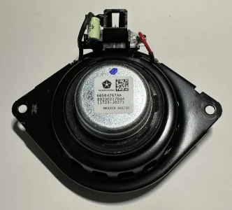

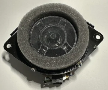

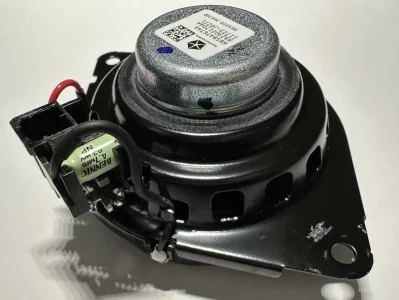

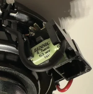

HK dash speakers
